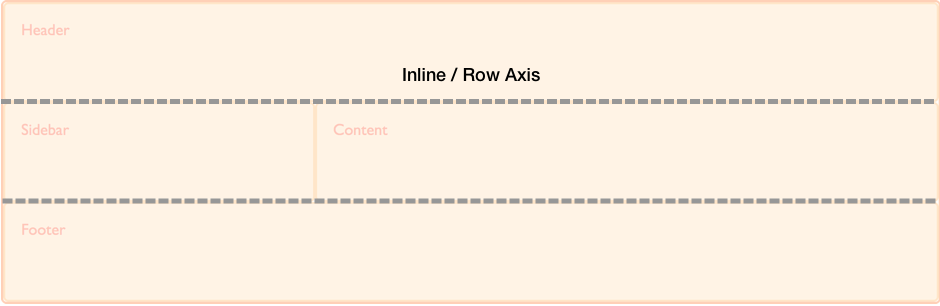

The two axes of a grid layout
When working with grid layout you have two axes available to align things against – the block axis and the inline axis. The block axis is the axis upon which blocks are laid out in block layout. If you have two paragraphs on your page they display one below the other, so it is this direction we describe as the block axis.
Block axes are vertical.
The inline axis runs across the block axis, it is the direction in which text in regular inline flow runs.
Inline / row axis are horizontal.
We are able to align the content inside grid areas, and the grid tracks themselves on these two axes.

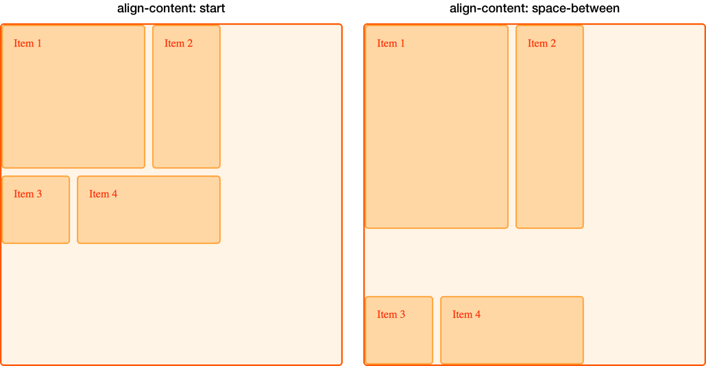

We can also apply the <content-distribution> space distribution values of space-between, space-around, space-evenly, and stretch. In this example, we set align-content, which aligns the tracks on the block axis, to space-between, which spaces out the tracks:
css
.wrapper {
  align-content: space-between;
If an item spans more than one grid track, using a space distribution value will likely cause items on your grid to become larger because the space that's added between the tracks is added to the spanning item. Therefore, if you use these values, make sure the content of the tracks can cope with the extra space or that you have used alignment properties on the items, so they move to the start or end rather than stretch.
In the below image, we placed the grid with two different align-content values to compare start and space-between. You can see how the first two items, which span two row tracks, have taken on extra height in the space-between example as they gain the space that exists because of the free space that was distributed between the three rows:
Demonstrating how items become larger if we use space-between.
